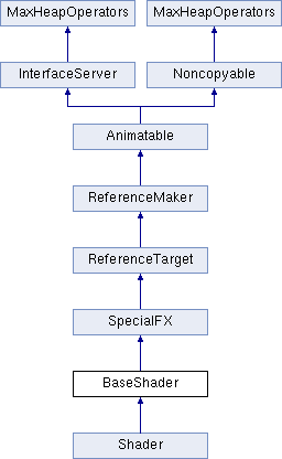

| RefResult | NotifyRefChanged (const Interval &changeInt, RefTargetHandle hTarget, PartID &partID, RefMessage message, BOOL propagate) |
|  | Receives and responds to messages.  More...
| SClass_ID | SuperClassID () |
|  | Retrieves a constant representing the type of the plugin.  More...
| BOOL | BypassPropertyLevel () |
|  | Wants to promote the shader properties to the material level.  More...
| virtual ULONG | GetRequirements (int subMtlNum)=0 |
|  | Returns the requirements of the Shader for the specified sub-material.  More...
| virtual long | nUserIllumOut () |
|  | Indicates the number of UserIllum output channels used by the shader.  More...
| virtual const MCHAR ** | UserIllumNameArray () |
|  | Returns a static array of channel names for matching by render elements.  More...
| virtual ShaderParamDlg * | CreateParamDialog (HWND hOldRollup, HWND hwMtlEdit, IMtlParams *imp, StdMat2 *theMtl, int rollupOpen, int n=0)=0 |
|  | Put up a dialog that lets the user edit the plug-ins parameters.  More...
| virtual ShaderParamDlg * | GetParamDlg (int n=0)=0 |
|  | Returns a pointer to the ShaderParamDlg object which manages the user interface.  More...
| virtual void | SetParamDlg (ShaderParamDlg *newDlg, int n=0)=0 |
|  | Sets the ShaderParamDlg object which manages the user interface to the one passed.  More...
| virtual int | NParamDlgs () |
|  | Returns the number of rollups this shader is requesting.  More...
| virtual ULONG | SupportStdParams ()=0 |
|  | Std parameter support.  More...
| virtual void | ConvertParamBlk (ParamBlockDescID *descOld, int oldCount, IParamBlock *oldPB) |
|  | Required for R2.5 shaders to convert the previous Standard material parameter blocks to the current version.  More...
| IOResult | Save (ISave *isave) |
|  | Saves and loads the plug-in's name.  More...
| IOResult | Load (ILoad *iload) |
|  | Loads the plug-in's name.  More...
| virtual void | GetIllumParams (ShadeContext &sc, IllumParams &ip)=0 |
|  | Updates the "channels"(as well as other) data member of the "IllumParams" object passed to it with the "local" variables of the material for possible mapping prior to being given to the Shader's Illum() method.  More...
| virtual void | Illum (ShadeContext &sc, IllumParams &ip)=0 |
|  | This is the illumination function for the Shader.  More...
| virtual void | ShadeReflection (ShadeContext &sc, IllumParams &ip, Color &mapClr) |
|  | Compute the reflected color from the sc, ip, and reflection map (or ray) color.  More...
| virtual void | ShadeTransmission (ShadeContext &sc, IllumParams &ip, Color &mapClr, float amount) |
|  | Compute the transmission/refraction color for the sample.  More...
| virtual void | AffectReflection (ShadeContext &sc, IllumParams &ip, Color &rcol) |
|  | This method was superseded by ShadeReflection() and is obsolete in release 4.0 and later.  More...
| virtual void | CombineComponents (ShadeContext &sc, IllumParams &ip) |
|  | Finalizes the compositing of the various illumination components.  More...
| virtual long | nTexChannelsSupported ()=0 |
|  | Returns the number of texture map map channels supported by this Shader.  More...
| virtual MSTR | GetTexChannelName (long nTextureChan)=0 |
|  | Returns the name of the specified texture map channel.  More...
| virtual MSTR | GetTexChannelInternalName (long nTextureChan) |
|  | Returns the internal name of the specified texture map.  More...
| virtual long | ChannelType (long nTextureChan)=0 |
|  | Returns the channel type for the specified texture map channel.  More...
| virtual long | StdIDToChannel (long stdID)=0 |
|  | Returns the index of this Shader's channels which corresponds to the specified Standard materials texture map ID.  More...
| virtual void | Reset ()=0 |
|  | Called when the Shader is first activated in the dropdown list of Shader choices.  More...
| virtual MSTR | GetName () |
| virtual BOOL | Active (TimeValue t) |
| virtual void | Update (TimeValue t, Interval &valid) |
| virtual SFXParamDlg * | CreateParamDialog (IRendParams *ip) |
| virtual BOOL | SetDlgThing (SFXParamDlg *dlg) |
| virtual int | NumGizmos () |
| virtual INode * | GetGizmo (int i) |
| virtual void | DeleteGizmo (int i) |
| virtual void | AppendGizmo (INode *node) |
| virtual BOOL | OKGizmo (INode *node) |
| virtual void | EditGizmo (INode *node) |
| virtual void | InsertGizmo (int i, INode *node) |
| CoreExport SvGraphNodeReference | SvTraverseAnimGraph (IGraphObjectManager *gom, Animatable *owner, int id, DWORD flags) |
| virtual CoreExport void | GetClassName (MSTR &s) |
|  | Retrieves the (localizable) name of the plugin class.  More...
| virtual BOOL | IsRefTarget () |
|  | Checks if this is a ReferenceTarget.  More...
| CoreExport RefResult | TestForLoop (const Interval &refInterval, RefMakerHandle hmaker) |
|  | Tests for a cyclical reference.  More...
| CoreExport BOOL | HasDependents () |
|  | Checks if a ReferenceTarget has references.  More...
| CoreExport BOOL | HasRealDependents () |
|  | Checks if this has Real (Strong) Dependents.  More...
| void | BeginDependencyTest () |
|  | Starts Dependency Test.  More...
| BOOL | EndDependencyTest () |
|  | Ends Dependency Test.  More...
| virtual void | RefAdded (RefMakerHandle rm) |
|  | Called after a reference is made to a target.  More...
| virtual void | RefAddedUndoRedo (RefMakerHandle rm) |
|  | Called after a reference is made to a target because of undo or redo.  More...
| virtual void | RefDeleted () |
|  | Called after a references to this is deleted.  More...
| virtual void | RefDeletedUndoRedo () |
|  | Called after a references to this is deleted because of undo or redo.  More...
| CoreExport RefResult | DeleteAllRefsToMe () |
|  | Deletes all references to this ReferenceTarget.  More...
| CoreExport RefResult | TransferReferences (RefTargetHandle oldTarget, BOOL delOld=FALSE) |
|  | Transfers all the references from oldTarget to this.  More...
| CoreExport int | DoEnumDependents (DependentEnumProc *dep) |
|  | Begins an enumeration that searches back in the dependency network.  More...
| virtual CoreExport RefTargetHandle | Clone (RemapDir &remap) |
|  | This method is used by 3ds Max to clone an object.  More...
| virtual CoreExport void | BaseClone (ReferenceTarget *from, ReferenceTarget *to, RemapDir &remap) |
|  | This method copies base class data from an object to its clone.  More...
| virtual CoreExport RefResult | NotifyDependents (const Interval &changeInt, PartID partID, RefMessage message, SClass_ID sclass=NOTIFY_ALL, BOOL propagate=TRUE, RefTargetHandle hTarg=NULL, NotifyDependentsOption notifyDependentsOption=REFNOTIFY_ALLOW_OPTIMIZATIONS) |
|  | Notify all dependent RefMakers concerned with the message.  More...
| void | FlagDependents (TimeValue t, PartID which=PART_PUT_IN_FG) |
|  | This sends the REFMSG_FLAGDEPENDENTS message up the pipeline.  More...
| virtual void | NotifyForeground (TimeValue t) |
|  | This method is called to flag dependents into the FG.  More...
| virtual void | NotifyTarget (int message, ReferenceMaker *hMaker) |
|  | Sends messages to ReferenceTargets.  More...
| virtual CoreExport void * | GetInterface (ULONG id) |
|  | Inherited from Animatable.  More...
| virtual CoreExport BaseInterface * | GetInterface (Interface_ID id) |
| CoreExport | ReferenceTarget () |
|  | Constructor.  More...
| virtual CoreExport RefResult | AutoDelete () |
|  | Deletes the object when it has no more real dependents.  More...
| CoreExport RefResult | MaybeAutoDelete () |
| CoreExport RefResult | ReplaceReference (int which, RefTargetHandle newtarg, BOOL delOld=TRUE) |
|  | Used when cloning reference makers.  More...
| CoreExport RefResult | DeleteAllRefsFromMe () |
|  | Deletes all references from this ReferenceMaker.  More...
| CoreExport RefResult | DeleteAllRefs () |
|  | Deletes all references both to and from this item.  More...
| CoreExport RefResult | DeleteReference (int i) |
|  | Deletes the specified reference.  More...
| virtual BOOL | CanTransferReference (int i) |
|  | Tells whether this reference can be transfered.  More...
| CoreExport ReferenceSaveManager & | GetReferenceSaveManager () |
|  | Access the ReferenceSaveManager of this ReferenceMaker.  More...
| virtual int | RemapRefOnLoad (int iref) |
|  | Used to load old files with references.  More...
| virtual CoreExport void | RescaleWorldUnits (float f) |
|  | Rescale size of all world units in reference hierarchy.  More...
| virtual CoreExport void | EnumAuxFiles (AssetEnumCallback &assetEnum, DWORD flags) |
|  | Enumerate auxiliary files (e.g. bitmaps)  More...
| virtual CoreExport void | SaveEnum (SaveEnumProc &sep, BOOL isNodeCall=0) |
|  | The default save enumeration.  More...
| virtual CoreExport bool | SpecifySaveReferences (ReferenceSaveManager &referenceSaveManager) |
|  | Used to specify reference slot remapping during scene file save.  More...
| CoreExport bool | EnumRefHierarchy (RefEnumProc &proc, bool includeCustAttribs=true, bool includeIndirectRefs=true, bool includeNonPersistentRefs=true, bool preventDuplicatesViaFlag=true) |
|  | This method provides a general purpose reference enumerator.  More...
| CoreExport int | FindRef (RefTargetHandle rtarg) |
|  | Get the index of the ReferenceTarget.  More...
| virtual BOOL | IsRefMaker () |
|  | Tells whether it is a ReferenceMaker.  More...
| virtual BOOL | IsRealDependency (ReferenceTarget *rtarg) |
|  | Returns whether this is a "real" (strong) dependency or not.  More...
| virtual BOOL | ShouldPersistWeakRef (RefTargetHandle rtarg) |
|  | Specifies whether a weak reference is to be persisted on a partial load or save.  More...
| CoreExport | ReferenceMaker () |
| CoreExport void | DeleteMe () |
|  | Deletes an instance of this class.  More...
| virtual CoreExport int | NumRefs () |
|  | Returns the total number of references this ReferenceMaker can hold.  More...
| virtual CoreExport RefTargetHandle | GetReference (int i) |
|  | Returns the 'i-th' reference.  More...
| virtual void | FreeCaches () |
| virtual int | NumChildren () |
| virtual Animatable * | ChildAnim (int i) |
| virtual CoreExport MSTR | NodeName () |
| virtual void | EditTrack () |
| virtual CoreExport BOOL | SubAnimSetKeyBufferPresent (int subNum) |
|  | returns true if the sub-anim has a "Set Key" buffer present  More...
| virtual BOOL | SetKeyBufferPresent () |
|  | returns true if there is a "Set Key" buffer present  More...
| virtual CoreExport void | SubAnimCommitSetKeyBuffer (TimeValue t, int subNum) |
|  | Commit any "Set Key" buffers on the given sub-anim.  More...
| virtual void | CommitSetKeyBuffer (TimeValue t) |
|  | Commit any "Set Key" buffers.  More...
| virtual CoreExport void | SubAnimRevertSetKeyBuffer (int subNum) |
|  | Revert any "Set Key" buffers on the given sub-anim.  More...
| virtual void | RevertSetKeyBuffer () |
