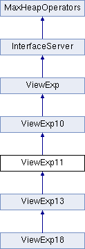

 Inheritance diagram for ViewExp11:
 Inheritance diagram for ViewExp11:| Public Member Functions | |
