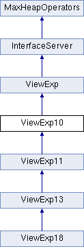

Extends ViewExp.
The following code example shows how to get access to this interface:
