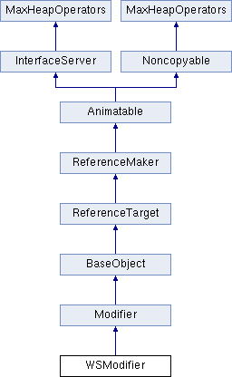

 Inheritance diagram for WSModifier:
 Inheritance diagram for WSModifier:| Public Member Functions | |
