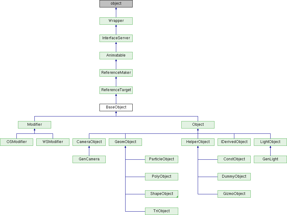

BaseObject Class Reference
+ Inheritance diagram for BaseObject:
