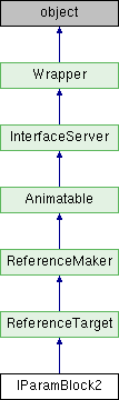

 Inheritance diagram for IParamBlock2:
 Inheritance diagram for IParamBlock2:| Public Member Functions | |
