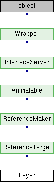

 Inheritance diagram for Layer:
 Inheritance diagram for Layer:| Public Member Functions | |

An interface to the Layers functionality. Layers override some properties of nodes.
