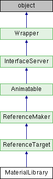

+ Inheritance diagram for MaterialLibrary:
