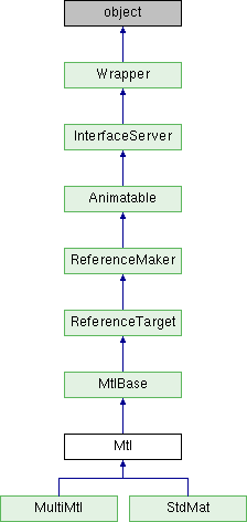

| def | CombineMaterials (*args) |
| def | CopySubMtl (self, *args) |
| def | GetActiveTexmap (self) |
| def | GetAmbient (self, mtlNum=0, backFace=True) |
| def | GetDiffuse (self, mtlNum=0, backFace=True) |
| def | GetNumSubMtls (self) |
| def | GetSelfIllum (self, mtlNum=0, backFace=True) |
| def | GetSelfIllumColor (self, mtlNum=0, backFace=True) |
| def | GetSelfIllumColorOn (self, mtlNum=0, backFace=True) |
| def | GetShininess (self, mtlNum=0, backFace=True) |
| def | GetShinyStrength (self, mtlNum=0, backFace=True) |
| def | GetSpecular (self, mtlNum=0, backFace=True) |
| def | GetSubMtl (self, *args) |
| def | GetSubMtlSlotName (self, *args) |
| def | GetSubMtlTVName (self, *args) |
| def | GetWireSize (self, mtlNum=0, backFace=True) |
| def | GetXParency (self, mtlNum=0, backFace=True) |
| def | SetActiveTexmap (self, *args) |
| def | SetAmbient (self, *args) |
| def | SetDiffuse (self, *args) |
| def | SetShininess (self, *args) |
| def | SetSpecular (self, *args) |
| def | SetSubMtl (self, *args) |
| def | SupportsRenderElements (self) |
| def | SupportsShaders (self) |
| def | VPDisplaySubMtl (self) |
| def | ActivateTexDisplay (self, *args) |
| def | AnyMulti (self) |
| def | ClearMtlFlag (self, *args) |
| def | DeactivateMapsInTree (self) |
| def | GetActiveMB (self) |
| def | GetFullName (self) |
| def | GetGBufID (self) |
| def | GetMeditObjType (self) |
| def | GetMEditRotate (self) |
| def | GetMeditTiling (self) |
| def | GetName (self) |
| def | GetRefTarget (self) |
| def | GetTransparencyHint (self, *args) |
| def | IsMultiMtl (self) |
| def | LocalMappingsRequired (self, *args) |
| def | LocalRequirements (self, *args) |
| def | MappingsRequired (self, *args) |
| def | MapSlotType (self, *args) |
| def | Requirements (self, *args) |
| def | Reset (self) |
| def | SetActiveMB (self, *args) |
| def | SetGBufID (self, *args) |
| def | SetMeditObjType (self, *args) |
| def | SetMeditTiling (self, *args) |
| def | SetMtlFlag (self, *args) |
| def | SetName (self, *args) |
| def | SupportsMultiMapsInViewport (self) |
| def | SupportTexDisplay (self) |
| def | TestMtlFlag (self, *args) |
| def | TextureDisplayEnabled (self) |
| def | Update (self, *args) |
| def | Validity (self, *args) |
| def | FindDependentNode (self) |
| def | MaybeAutoDelete (self) |
| def | NotifyTarget (self, *args) |
| def | ClearFlagInHierarchy (self, *args) |
| def | DeleteMe (self) |
| def | DeleteReference (self, *args) |
| def | FindRef (self, *args) |
| def | GetNumRefs (self) |
| def | GetReference (self, *args) |
| def | NotifyChanged (self) |
| def | NotifyDependents (self, *args) |
| def | ReplaceReference (self, *args) |
| def | RescaleWorldUnits (self, *args) |
| def | AddNewKey (self, *args) |
| def | AssignController (self, *args) |
| def | CanAssignController (self, *args) |
| def | CanCopyAnim (self) |
| def | CanCopyTrack (self, *args) |
| def | CanDeleteSubAnim (self, *args) |
| def | CanMakeUnique (self) |
| def | ClearAFlag (self, *args) |
| def | ClearAFlagEx (self, *args) |
| def | ClearAllAppData (self) |
| def | ClearFlagBit (self, *args) |
| def | ClearFlagInAllAnimatables (*args) |
| def | CopyKeysFromTime (self, *args) |
| def | DeleteAppData (self, *args) |
| def | DeleteKeyAtTime (self, *args) |
| def | DeleteKeyByIndex (self, *args) |
| def | DeleteKeys (self, *args) |
| def | DeleteSubAnim (self, *args) |
| def | DeleteTime (self, *args) |
| def | DoesSupportTimeOperations (self) |
| def | EditTimeRange (self, *args) |
| def | FreeCaches (self) |
| def | GetAnimByHandle (*args) |
| def | GetAnimHandle (self) |
| def | GetAppData (self, *args) |
| def | GetClassID (self) |
| def | GetClassName (self) |
| def | GetCustomAttributeContainer (self) |
| def | GetHasSubElements (self, type=0) |
| def | GetKeyIndex (self, *args) |
| def | GetKeyTime (self, *args) |
| def | GetNextKeyTime (self, *args) |
| def | GetNodeName (self) |
| def | GetNumKeys (self) |
| def | GetNumSubAnims (self) |
| def | GetParameterBlock (self) |
| def | GetSubAnim (self, *args) |
| def | GetSubAnimName (self, *args) |
| def | GetSuperClassID (self) |
| def | GetTimeRange (self, *args) |
| def | InsertTime (self, *args) |
| def | IsAnimated (self) |
| def | IsKeyAtTime (self, *args) |
| def | IsSubClassOf (self, *args) |
| def | MoveKeys (self, *args) |
| def | ReverseTime (self, *args) |
| def | ScaleKeyValues (self, *args) |
| def | ScaleTime (self, *args) |
| def | SetAFlag (self, *args) |
| def | SetAFlagEx (self, *args) |
| def | SetAppData (self, *args) |
| def | SetFlagBit (self, *args) |
| def | SubNumToRefNum (self, *args) |
| def | TestAFlag (self, *args) |
| def | TestAFlagEx (self, *args) |
| def | TestFlagBit (self, *args) |
| def | GetInterface (self, *args) |
| def | GetUnwrappedPtr (self) |
|  | Ambient = _swig_property(GetAmbient, SetAmbient) |
|  | CombineMaterials = staticmethod(CombineMaterials) |
|  | Diffuse = _swig_property(GetDiffuse, SetDiffuse) |
|  | SelfIllumColor = _swig_property(GetSelfIllumColor, SetSpecular) |
|  | Shininess = _swig_property(GetShininess, SetShininess) |
|  | Specular = _swig_property(GetSpecular, SetSpecular) |
|  | SubMtls = _swig_property(lambda self: (self.GetSubMtl(i) for i in xrange(self.GetNumSubMtls()))) |
|  | thisown = _swig_property(lambda x: x.this.own(), lambda x, v: x.this.own(v), doc='The membership flag') |
|  | NumRefs = _swig_property(GetNumRefs) |
|  | Refs = _swig_property(lambda self: (self.GetReference(i) for i in xrange(self.GetNumRefs()))) |
|  | AnimHandle = _swig_property(GetAnimHandle) |
|  | ClassID = _swig_property(GetClassID) |
|  | ClearFlagInAllAnimatables = staticmethod(ClearFlagInAllAnimatables) |
|  | GetAnimByHandle = staticmethod(GetAnimByHandle) |
|  | KeyTimes = _swig_property(lambda self: (self.GetKeyTime(i) for i in xrange(self.GetNumKeys()))) |
|  | NodeName = _swig_property(GetNodeName) |
|  | NumSubAnims = _swig_property(GetNumSubAnims) |
|  | ParameterBlock = _swig_property(GetParameterBlock) |
|  | SubAnimNames = _swig_property(lambda self: (self.GetSubAnimName(i) for i in xrange(self.GetNumSubAnims()))) |
|  | SubAnims = _swig_property(lambda self: (self.GetSubAnim(i) for i in xrange(self.GetNumSubAnims()))) |
|  | SuperClassID = _swig_property(GetSuperClassID) |
