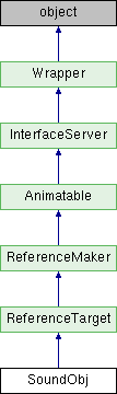

SoundObj Class Reference
+ Inheritance diagram for SoundObj:
