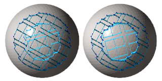

Duplicate support
With this option you can control whether triangles of a cluster should get supported with the respective action even when a previous action in the script has already applied support to the same triangles. By overlapping supported areas like that, you can create stepped support density that is stronger where the downskin's angle is particularly shallow, for example.
This sphere was supported with a script that included two actions with different values for cluster detection each. The smaller cluster was determined first (with a critical angle smaller than the larger cluster's). Left: Duplicate support tolerated. Right: Avoided.
Note: Technically, this compares the detected clusters first before generating the actual supports. This means that if you have two support actions that both detect the same clusters, the second action (set to avoid duplicate clusters) does not generate any supports even when there would be space in the cluster to fit. For such cases, set this to tolerate duplicate support and also set Keep distance to support to Yes.
Avoid, Tolerate

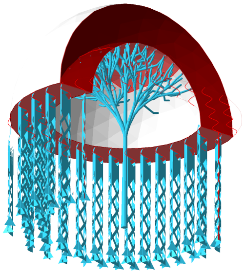

Area with Volume Support
Parameter Description Notes
Cluster
Refer to the Cluster Detection section.

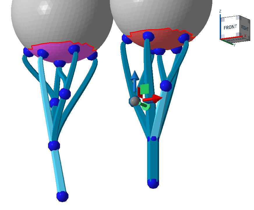

Bouquet-structure type
Netfabb knows two methods to bundle bar supports together. The classical one picks one main bar and grows additional bars from it or from other bars that originate on the main bar themselves ("side branching"). The other, newer method uses proper iterative splitting of bars into ever thinner ones to ultimately cover the cluster's entire surface area with supports ("split branching").
Side branching
  • The entire bouquet can be shifted at once by moving its singular bottom termination point, and all attached bars adjust "organically".
  • Anchors where bars terminate on other bars can only be moved along those bars. This makes editing less destructive, but also somewhat limited.
  • All bars have the same diameter regardless how many or few bars terminate in them. This can limit their use where actual load-bearing is a determining factor.
Split branching
  • When bars split (or merge), the cross section area is distributed (or combined) accordingly, too.
  • Anchors where splits happen can be moved individually in all directions, and the segments between anchors are individual bar entities. This allows more freedom but at the same time requires more attention to positioning.
  • Since anchors are independent, they do not move proportionately. All selected anchors move by the same amount and in the same direction.
Side branching (left) and split branching (right). Note how the selected one on the left goes all the way from the part surface to the bottom, and how other beams "sprout" from it, whereas on the right, the branches split evenly.

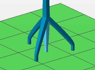

Root system
When active, the bottom of the bars are multiplied to form a tree-root-like structure that reinforces the adherence of individual bars.
Number of legs
The count of legs includes the center one.
Height
At this height above the platform or the bottom part surface, measured along the center leg, the side legs merge with the main bar.
Diameter
The side bars terminate at a circular contour of this diameter parallel to the build platform. If the bars meet a suitable surface before or beyond this imaginary circle, such as when they terminate on an uneven part surface, the bars are shortened or extended appropriately to maintain the side bar angle.

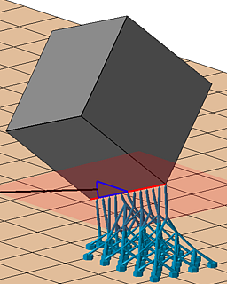

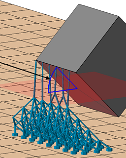

Project bar
Controls angling bar support entities to preferrably hit or avoid part surface.
Options
  • No projection: No part-to-part avoidance is attempted
  • To platform: Bars that would hit part surface are angled to hit platform surface instead.
  • To opposite surface: Bars are projected from the downskin to hit any surface, part or platform.
  • To selected anchor: Bars are projected from the downskin to preferrably hit selected anchors.
    Note: This option can only be used manually, by executing the script action from the Scripts listing, as a fully automatic execution deletes and regenerates all anchors freshly.
  • To upskin: Bars are projected from the downskin to preferrably hit upskin areas. To determine upskin areas, the same angles as for determining downskin clusters apply.

Comparison of adaptation. Three adaptive steps lighten the lattice considerably more than just one step.
Adaptive steps
The rule of collapsing multiple fully intact lattice cells into the next larger cell size is applied up to this many times. Note that this is only the permissible maximum. If there aren't enough intact cells in a contiguous 2×2×2 arrangement, no collapsing is performed.
