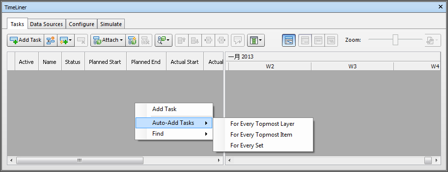

  2. Create some tasks, each having a name, start and end date and a task type. You can add tasks manually. Alternatively, click Auto-Add Tasks on the Tasks tab, or right-click within the Tasks area, and create an initial set of tasks based on layer, item, or selection set names. TimeLiner defines some default task types for you (Construct, Demolish and Temporary), or you can define your own task types on the Configure Tab. You can also view a read-only graphical representation of your project schedule, and can switch between Planned, Actual, and Planned vs Actual Gantt charts.

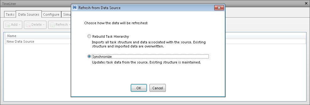

    You can use the Data Sources Tab to import tasks from an external source, such as Microsoft Project™. You can choose a field from the external schedule to define the types of the imported tasks, or you can set task types by hand. You can edit task parameters directly in TimeLiner. You can also update the schedule externally and refresh the tasks in TimeLiner to align them with those from the external source. Any changes you make to tasks imported from external project files will be overwritten next time you refresh the corresponding data sources.

    If you used the auto-add tasks functionality on the Tasks Tab to create an initial set of tasks based on layer, item or selection set names, then the corresponding layers, items or selection sets will already be attached for you.

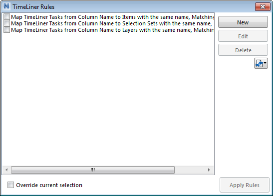

    Alternatively, you can click Auto-Attach Using Rules and Use Rules to Attach Tasks automatically.

  7. Keep up to date with changes in your project. Save your project as a Autodesk Navisworks NWF file. Open the NWF and Synchronize Tasks with Project Changes.
