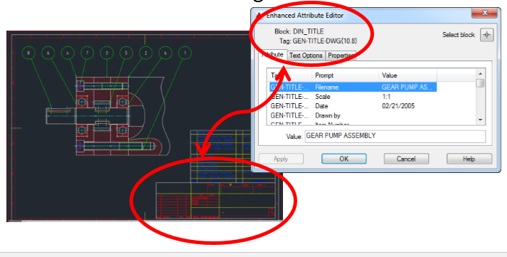

Know Your Title Block Names
Record the title block names that are used in your drawings. These names must be enabled in Vault before you can map them. The names must match exactly for mappings to succeed.
