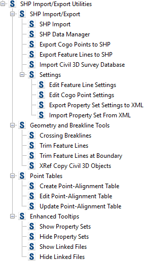

Use the Toolbox tab in Toolspace to access the SHP Import/Export commands.
