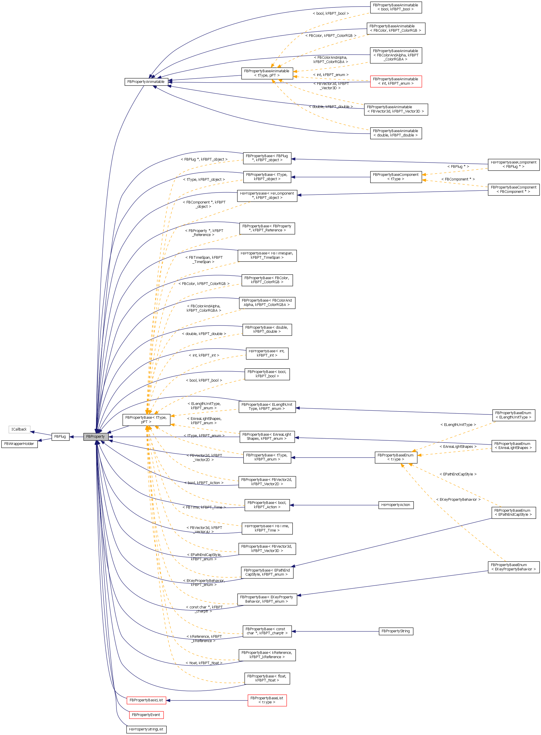

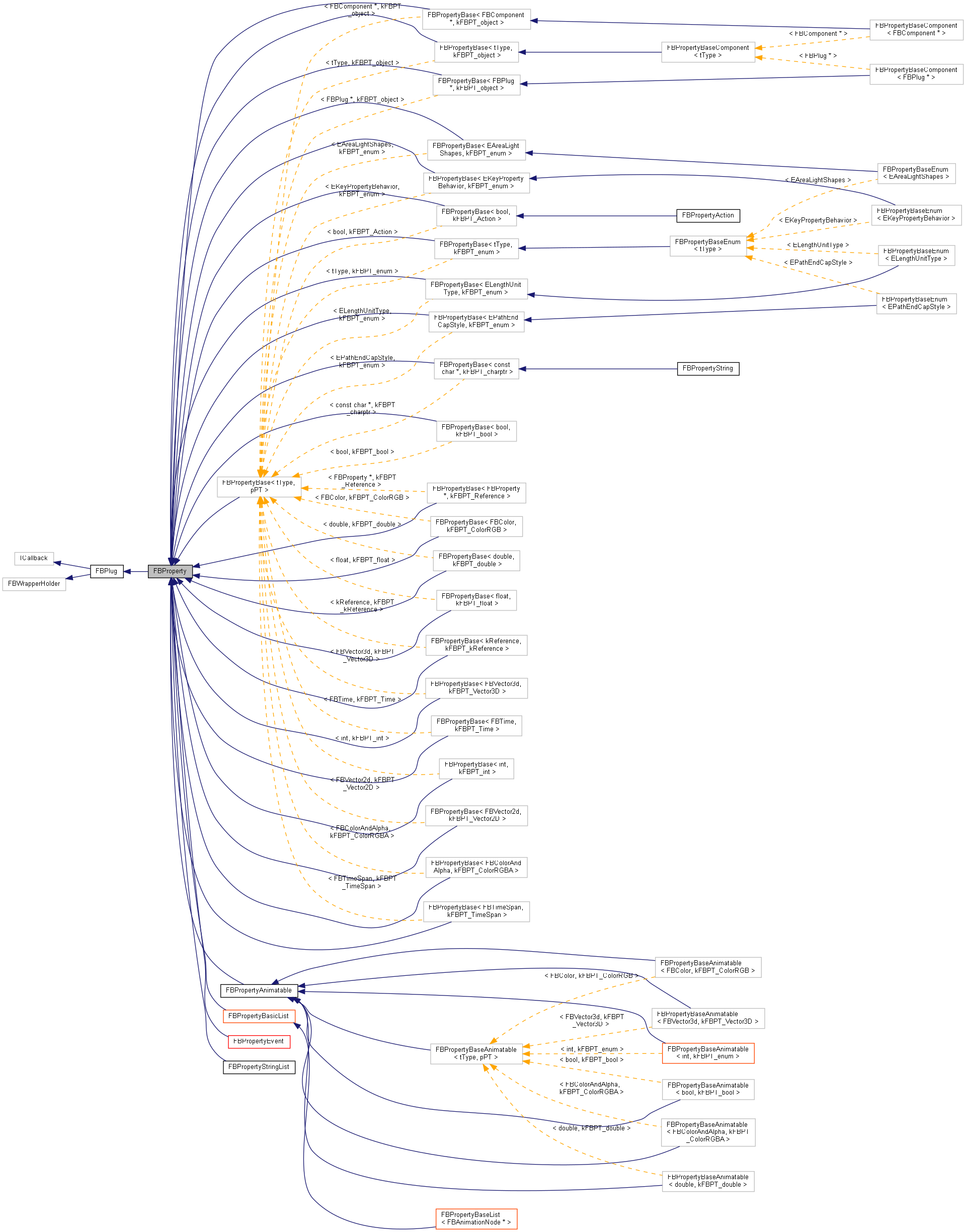

Property: Base property class.
A property is a holder for function callbacks into the internals of the application.
You cannot instantiate FBProperty objects. To reference a property:
To see how to create a custom property in Python, see CustomProperty.py.
Definition at line 194 of file fbproperties.h.
