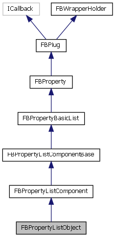

List of scene objects.
This list is a more generic container often used as object properties. The types of actual object that it can contain can be specialized.
Definition at line 555 of file fbcomponent.h.
