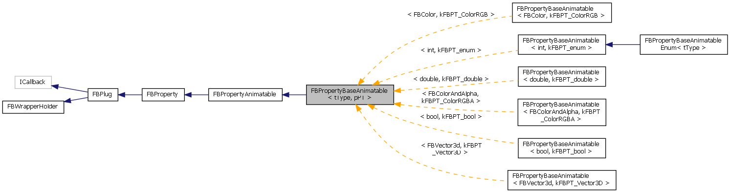

Public Types | |
| typedef tType | ValueType |
| Property Value Type. More... | |
Public Member Functions | |
| FBPropertyBaseAnimatable () | |
| Constructors. More... | |
| FBPropertyBaseAnimatable (const FBPropertyBaseAnimatable< tType, pPT > &pValue) | |
| ~FBPropertyBaseAnimatable () | |
| Destructor. More... | |
| void | operator= (tType pValue) |
| Overloaded = operator. More... | |
| operator tType () const | |
| Overloaded cast to tType operator. More... | |
| virtual FBPropertyType | GetPropertyType () override |
| Get the property's type. More... | |
Public Member Functions inherited from FBPropertyAnimatable | |
| FBPropertyAnimatable () | |
| Constructor. More... | |
| virtual | ~FBPropertyAnimatable () |
| FBPropertyAnimatable * | Init (FBBox *pOwner, const char *pName, const char *pType, double *pInit) |
| Initialization function (custom). More... | |
| void | Destroy () |
| Destruction function, for internal connectors. More... | |
| virtual KDataType * | GetDataType () override |
| Get the property datatype pointer. More... | |
| const char * | GetDataTypeName () |
| Get the property datatype name. More... | |
| bool | IsFocused () |
| Is the property focused (keyable). More... | |
| void | SetFocus (bool pState) |
| Set the property's focus (keyable) state. More... | |
| void | Key () |
| Key the property. More... | |
| void | KeyAt (FBTime pTime) |
| Key the property at time (t). More... | |
| void | KeyRemoveAt (FBTime pTime) |
| Remove the key at time (t). More... | |
| int | GetDataSize () const |
| Get the data size (number of values) for the connector. More... | |
| virtual bool | IsAnimatable () override |
| Certify that the property is animatable. More... | |
| bool | IsAnimated () |
| Is the property animated. More... | |
| void | SetAnimated (bool pState, bool pCheckLocked=false) |
| Set the animation state of the property. More... | |
| FBAnimationNode * | GetAnimationNode (FBTake *pTake=NULL) |
| Get the animation node for the property. More... | |
| FBBox * | GetBox () |
| Get the owner box. More... | |
| virtual void | SetData (void *pData) override |
| Set the value of the property, passing the type as an argument. More... | |
| virtual void | GetData (void *pData, int pSize, FBEvaluateInfo *pEvalInfo=NULL) const override |
| Get the value of a property. More... | |
| void | SetCandidate (void *pData, int pSize, FBEvaluateInfo *pEvalInfo=NULL) |
| Set the candidate. More... | |
| void | SetGlobalCandidate (void *pData, int pSize, FBEvaluateInfo *pEvalInfo=NULL) |
| Set the global candidate (useful for model TRS). More... | |
| bool | AllowsMuting () const |
| AllowsMuting. More... | |
| bool | HasSomethingMuted () const |
| HasSomethingMuted. More... | |
| bool | IsMuted () const |
| IsMuted. More... | |
| bool | IsMemberMuted (int pIndex) const |
| IsMemberMuted. More... | |
| void | SetMuted (bool pMuted) |
| SetMuted. More... | |
| void | SetMemberMuted (int pIndex, bool pMuted) |
| SetMemberMuted. More... | |
| bool | SetColor (const FBColor &pColor, int pIndex) |
| Set the color of the FCurves for the property. More... | |
| FBColor | GetColor (int pIndex) |
| Get the color of a particular FCurve of the property. More... | |
| bool | ResetColor (int pIndex) |
| Revert the FCurves to their default color. More... | |
| bool | IsFocusedChild (int pIndex) |
| Get the focus (keyable) state of child component. More... | |
| bool | SetFocusChild (int pIndex, bool pState) |
| Set the focus (keyable) state of child component. More... | |
Public Member Functions inherited from FBProperty | |
| FBProperty () | |
| void | SetEnable (bool pValue) |
| Set property enable status. More... | |
| const char * | GetName () |
| Get the property's name. More... | |
| void | SetName (const char *pName) |
| Set the property's name. More... | |
| const char * | GetPropertyTypeName () |
| Get the property's type name. More... | |
| int | AsInt () |
| Get the property as an integer. More... | |
| bool | SetInt (int pInt) |
| Set the property from an integer. More... | |
| virtual const char * | AsString (FBDataAsStringFlag pFlag=kFBDataAsStringUI) |
| Get the property value as a string. More... | |
| virtual bool | SetString (const char *pString) |
| Set the property value from a string. More... | |
| const char * | OriValueAsString () |
| Get the property original value (before any modification) as string. More... | |
| bool | IsAnimated () const |
| Get the property animated flag status. More... | |
| bool | OriIsAnimated () const |
| Get the property original animated flag status (before any modification) More... | |
| virtual bool | IsList () |
| Verify if property is of this type. More... | |
| bool | IsInternal () const |
| bool | IsUserProperty () |
| bool | IsTextureConnectableProperty () |
| bool | IsReferenceProperty () |
| bool | IsMinClamp () |
| Indicate if minimum value clamping will be applied on user input value. More... | |
| bool | IsMaxClamp () |
| Indicate if maximum value clamping will be applied on user input value. More... | |
| bool | IsTemporaryProperty () |
| Indicate if a property was created on retrieve because it didn't exist. More... | |
| bool | AcceptTemporaryProperty (const char *pEnumList[]=NULL, fbExternalGetSetHandler pGet=NULL, fbExternalGetSetHandler pSet=NULL) |
| Accept a temporary property as a dynamic property. More... | |
| bool | IsObjectList () |
| Indicate if is an instance of FBPropertyListObject. More... | |
| virtual bool | IsReadOnly () |
| Is property read-only? More... | |
| virtual const char * | EnumList (int pIndex) |
| Return the string of an enum value. More... | |
| FBStringList * | GetEnumStringList (bool pCreateIt=false) |
| String list for enum properties. More... | |
| void | NotifyEnumStringListChanged () |
| Notify system that the enum list was modified. More... | |
| void | ModifyPropertyFlag (FBPropertyFlag pFlag, bool pValue) |
| ModifyPropertyFlag. More... | |
| FBPropertyFlag | GetPropertyFlags () |
| GetPropertyFlags. More... | |
| bool | GetPropertyFlag (FBPropertyFlag pFlag) |
| GetPropertyFlag. More... | |
| void | SetMinMax (double pMin, double pMax, bool pForceMinClamp=false, bool pForceMaxClamp=false) |
| SetMinMax. More... | |
| void | SetMin (double pMin, bool pForceMinClamp=false) |
| SetMin. More... | |
| void | SetMax (double pMax, bool pForceMaxClamp=false) |
| SetMax. More... | |
| double | GetMin () |
| GetMin. More... | |
| double | GetMax () |
| GetMax. More... | |
| void * | GetParent () |
| Get the parent of the object. More... | |
| int | GetSubMemberCount () const |
| GetSubMemberCount. More... | |
| bool | AllowsLocking () const |
| AllowsLocking. More... | |
| bool | HasSomethingLocked () const |
| HasSomethingLocked. More... | |
| bool | IsLocked () const |
| IsLocked. More... | |
| bool | IsMemberLocked (int pIndex) const |
| IsMemberLocked. More... | |
| void | SetLocked (bool pLocked) |
| SetLocked. More... | |
| void | SetMemberLocked (int pIndex, bool pLocked) |
| SetMemberLocked. More... | |
| FBProperty * | GetReferencedProperty () |
| Get the referenced property, in the case of this property is a reference property (see the IsReferenceProperty() method). More... | |
Public Member Functions inherited from FBWrapperHolder | |
| FBScriptWrapper * | GetWrapper () |
| Return the wrapper interface of this FBObject. More... | |
| void | AddWrapper (FBScriptWrapper *) |
| void | RemoveWrapper (FBScriptWrapper *) |
Additional Inherited Members | |
Protected Member Functions inherited from FBPlug | |
| bool | IsSDKComponent () |
| Return whether or not item is an SDK component. More... | |
| bool | ConnectSrc (FBPlug *pSrc, FBConnectionType pConnectionType=kFBConnectionTypeNone) |
| Add a source connection. More... | |
| bool | ConnectDst (FBPlug *pDst, FBConnectionType pConnectionType=kFBConnectionTypeNone) |
| Add a destination connection. More... | |
| bool | ConnectSrcAt (int pDst_SrcIndex, FBPlug *pSrc, FBConnectionType pConnectionType=kFBConnectionTypeNone) |
| bool | ConnectDstAt (int pSrc_DstIndex, FBPlug *pDst, FBConnectionType pConnectionType=kFBConnectionTypeNone) |
| bool | DisconnectDst (FBPlug *pDst) |
| Remove a destination connection. More... | |
| bool | DisconnectSrc (FBPlug *pSrc) |
| Remove a source connection. More... | |
| void | DisconnectAllSrc () |
| Remove all source connections. More... | |
| void | DisconnectAllDst () |
| Remove all destination connections. More... | |
| bool | DisconnectDstAt (int pIndex) |
| Remove a destination connection at a specified index. More... | |
| bool | DisconnectSrcAt (int pIndex) |
| Remove a source connection at a specified index. More... | |
| bool | ReplaceDstAt (int pIndex, FBPlug *pDst) |
| Replace a destination connection at a specified index. More... | |
| bool | ReplaceSrcAt (int pIndex, FBPlug *pSrc) |
| Replace a source connection at a specified index. More... | |
| bool | SwapSrc (int pIndexA, int pIndexB) |
| Swap source connection at index A with source connection at index B. More... | |
| bool | MoveSrcAt (int pIndex, int pAtIndex) |
| Move source connection at pIndex to pAtIndex. More... | |
| bool | MoveSrcAt (FBPlug *pSrc, FBPlug *pAtSrc) |
| Move source connection pSrc to the position of pAtSrc. More... | |
| int | GetSrcCount () |
| Get source connection count. More... | |
| FBPlug * | GetSrc (int pIndex) |
| Get a source connection's plug at specified index. More... | |
| FBConnectionType | GetSrcType (int pIndex) |
| Get a source connection's type at specified index. More... | |
| int | GetDstCount () |
| Get destination connection count. More... | |
| FBPlug * | GetDst (int pIndex) |
| Get a destination connection's plug at specified index. More... | |
| FBConnectionType | GetDstType (int pIndex) |
| Get a destination connection's type at specified index. More... | |
| bool | BeginChange () |
| Begins a change on multiple plugs. More... | |
| void | EndChange () |
| Ends a change on multiple plugs. More... | |
| void | SetSelfModified (FBPlugModificationFlag pFlag, bool pBool) |
| Set the plug's self modification flag. More... | |
| bool | GetSelfModified (FBPlugModificationFlag pFlag) |
| Tell if the plug's self has changed. More... | |
| void | SetContentModified (FBPlugModificationFlag pFlag, bool pBool) |
