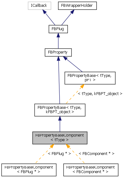

template<class tType>
class FBPropertyBaseComponent< tType >
Definition at line 1216 of file fbproperties.h.
