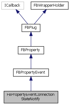

PropertyEvent: Global ConnectionStateNotify event. More...
#include <fbproperties.h>
Definition at line 604 of file fbproperties.h.
