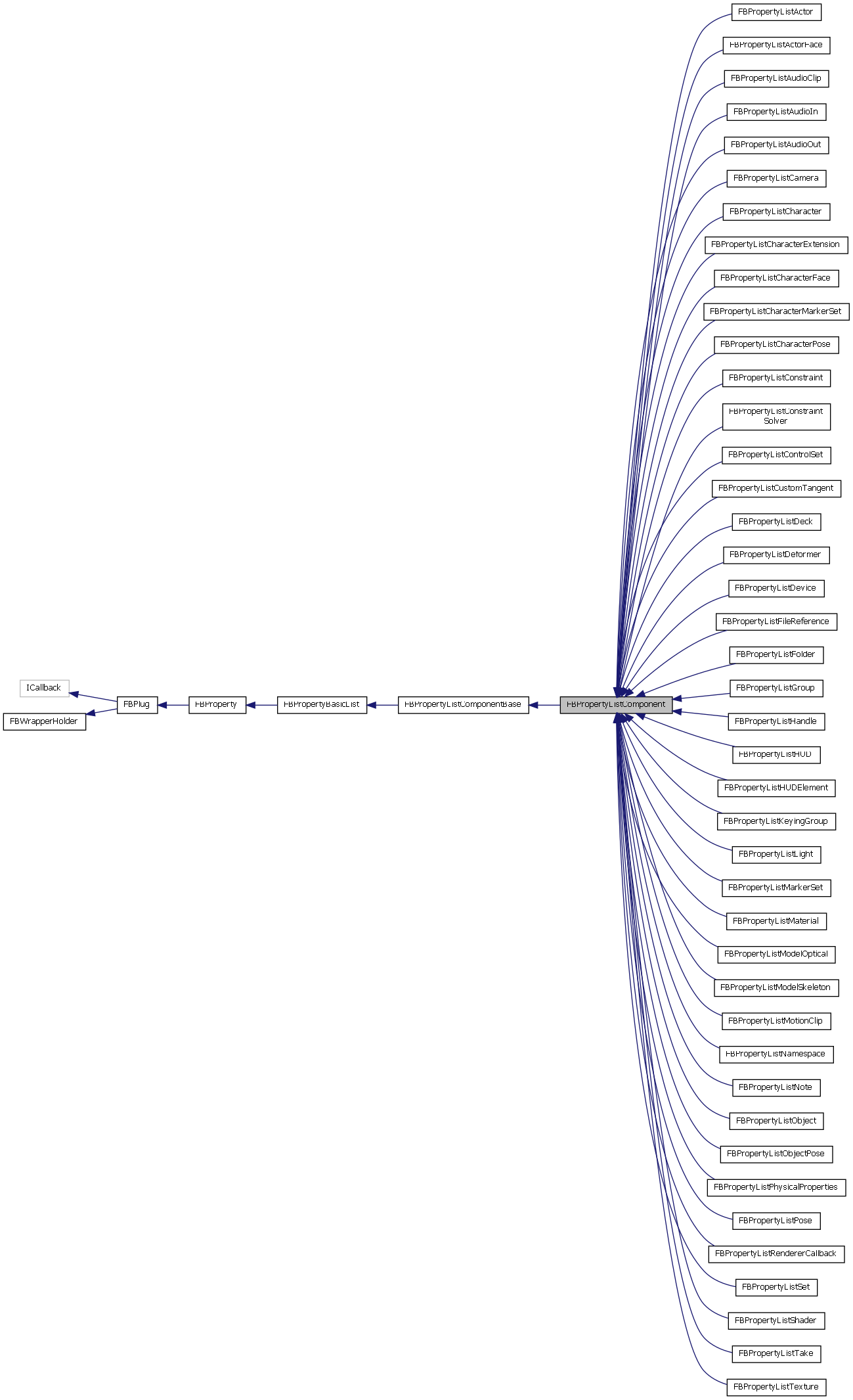

PropertyList: Concrete class for PropertyList of component More...
#include <fbcomponent.h>
