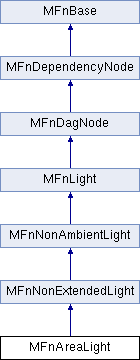

Inheritance diagram for MFnAreaLight:Public Member Functions | |
