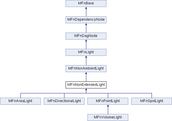

| virtual MFn::Type | type () const |
| | Function set type. More...
| virtual | ~MFnNonExtendedLight () |
| | Destructor. More...
| | Default constructor.
| | MFnNonExtendedLight (MObject &object, MStatus *ReturnStatus=NULL) |
| | Constructor. More...
| | MFnNonExtendedLight (const MDagPath &object, MStatus *ret=NULL) |
| float | shadowRadius (MStatus *ReturnStatus=NULL) const |
| | Retrieves the value of the "shadowRadius" attribute of a non-extended light node. More...
| MStatus | setShadowRadius (const float &shadow_radius) |
| | Sets the value of the "shadowRadius" attribute of a non-extended light node. More...
| bool | castSoftShadows (MStatus *ReturnStatus=NULL) const |
| | Retrieves the value of the "castSoftShadows" attribute of a non-extended light node. More...
| MStatus | setCastSoftShadows (const bool &cast_soft_shadows) |
| | Sets the value of the "castSoftShadows" attribute of a non-extended light node. More...
| bool | useDepthMapShadows (MStatus *ReturnStatus=NULL) const |
| | Retrieves the value of the "useDepthMapShadows" attribute of a non-extended light node. More...
| MStatus | setUseDepthMapShadows (const bool &use_depth_map) |
| | Sets the value of the "useDepthMapShadows" attribute of a non-extended light node. More...
| short | depthMapFilterSize (MStatus *ReturnStatus) const |
| | Retrieves the value of the "depthMapFilterSize" attribute of a light node. More...
| MStatus | setDepthMapFilterSize (const short &depth_map_filter_size) |
| | Sets the value of the "depthMapFilterSize" attribute of a light node. More...
| short | depthMapResolution (MStatus *ReturnStatus) const |
| | Retrieves the value of the "depthMapResolution" attribute of a light node. More...
| MStatus | setDepthMapResolution (const short &depth_map_resolution) |
| | Sets the value of the "depthMapResolution" attribute of a light node. More...
| float | depthMapBias (MStatus *ReturnStatus) const |
| | Retrieves the value of the "depthMapBias" attribute of a light node. More...
| MStatus | setDepthMapBias (const float &depth_map_bias) |
| | Sets the value of the "depthMapBias" attribute of a light node. More...
| bool | useDepthMapAutoFocus (MStatus *ReturnStatus=NULL) const |
| | Retrieves the value of the "useDepthMapAutoFocus" attribute of a non-extended light node. More...
| MStatus | setUseDepthMapAutoFocus (const bool use_depth_map_auto_focus) |
| | Sets the value of the "useDepthMapAutoFocus" attribute of a non-extended light node. More...
| float | depthMapWidthFocus (MStatus *ReturnStatus) const |
| | Retrieves the value of the "depthMapWidthFocus" attribute of a light node. More...
| MStatus | setDepthMapWidthFocus (const float depth_map_width_focus) |
| | Sets the value of the "depthMapWidthFocus" attribute of a light node. More...
| float | depthMapFocus (MStatus *ReturnStatus) const |
| | Retrieves the value of the "depthMapFocus" attribute of a light node. More...
| MStatus | setDepthMapFocus (const float depth_map_focus) |
| | Sets the value of the "depthMapFocus" attribute of a light node. More...
| | MFnNonExtendedLight (const MObject &object, MStatus *ret=NULL) |
| virtual | ~MFnNonAmbientLight () |
| | Destructor. More...
| | MFnNonAmbientLight (MObject &object, MStatus *ReturnStatus=NULL) |
| | MFnNonAmbientLight (const MDagPath &object, MStatus *ret=NULL) |
| short | decayRate (MStatus *ReturnStatus=NULL) const |
| | Retrieves the value of the "decayRate" attribute of a non-ambient light node. More...
| MStatus | setDecayRate (const short &decay_rate) |
| | Sets the value of the "decayRate" attribute of a non-ambient light node. More...
| | MFnNonAmbientLight (const MObject &object, MStatus *ret=NULL) |
| virtual | ~MFnLight () |
| | Destructor. More...
| MFnLight () |
| | MFnLight (MObject &object, MStatus *ReturnStatus=NULL) |
| | MFnLight (const MDagPath &object, MStatus *ret=NULL) |
| MColor | color (MStatus *ReturnStatus=NULL) const |
| | Retrieves the value of the "color" attribute of a light node. More...
| MStatus | setColor (const MColor &col) |
| | Sets the value of the "color" attribute of a light node. More...
| float | intensity (MStatus *ReturnStatus=NULL) const |
| | Retrieves the value of the "intensity" attribute of a light node. More...
| MStatus | setIntensity (const float &intens) |
| | Sets the value of the "intensity" attribute of a light node. More...
| bool | useRayTraceShadows (MStatus *ReturnStatus=NULL) const |
| | Retrieves the value of the "useRayTraceShadows" attribute of a light node. More...
| MStatus | setUseRayTraceShadows (const bool &useRayTraceShadows) |
| | Sets the value of the "useRayTraceShadows" attribute of a light node. More...
| MColor | shadowColor (MStatus *ReturnStatus=NULL) const |
| | Retrieves the value of the "shadowColor" attribute of a light node. More...
| MStatus | setShadowColor (const MColor &shadow_color) |
| | Sets the value of the "shadowColor" attribute of a light node. More...
| double | centerOfIllumination (MStatus *ReturnStatus=NULL) const |
| | Retrieves the value of the "centerOfIllumination" attribute of a light node. More...
| MStatus | setCenterOfIllumination (const double &dist) |
| | Sets the value of the "centerOfIllumination" attribute of a light node. More...
| short | numShadowSamples (MStatus *ReturnStatus=NULL) const |
| | Retrieves the value of the "numShadowSamples" attribute of a light node. More...
| MStatus | setNumShadowSamples (const short &num_shadow_samples) |
| | Sets the value of the "numShadowSamples" attribute of a light node. More...
| short | rayDepthLimit (MStatus *ReturnStatus=NULL) const |
| | Retrieves the value of the "rayDepthLimit" attribute of a light node. More...
| MStatus | setRayDepthLimit (const short &rayDepthLimit) |
| | Sets the value of the "rayDepthLimit" attribute of a light node. More...
| MColor | opticalFXvisibility (MStatus *ReturnStatus=NULL) const |
| | Retrieves the value of the "opticalFXvisibility" attribute of a light node. More...
| MStatus | setOpticalFXvisibility (const MColor &visibility) |
| | Sets the value of the "opticalFXvisibility" attribute of a light node. More...
| MColor | lightIntensity (MStatus *ReturnStatus=NULL) const |
| | Retrieves the value of the "lightIntensity" attribute of a light node. More...
| MFloatVector | lightDirection (int instance, MSpace::Space space=MSpace::kWorld, MStatus *ReturnStatus=NULL) const |
| | Returns the direction in which the light is pointing. More...
| MFloatVector | lightDirection (MStatus *ReturnStatus=NULL) const |
| | Retrieves the value of the "lightDirection" attribute of a light node. More...
| bool | lightAmbient (MStatus *ReturnStatus=NULL) const |
| | Retrieves the value of the "lightAmbient" attribute of a light node. More...
| bool | lightDiffuse (MStatus *ReturnStatus=NULL) const |
| | Retrieves the value of the "lightDiffuse" attribute of a light node. More...
| bool | lightSpecular (MStatus *ReturnStatus=NULL) const |
| | Retrieves the value of the "lightSpecular" attribute of a light node. More...
| | MFnLight (const MObject &object, MStatus *ret=NULL) |
| virtual | ~MFnDagNode () |
| | Destructor. More...
| | MFnDagNode () |
| | Class Constructor. More...
| | MFnDagNode (MObject &object, MStatus *ret=NULL) |
| | Not available in Python. More...
| | MFnDagNode (const MDagPath &object, MStatus *ret=NULL) |
| MObject | create (const MTypeId &typeId, MObject &parent=MObject::kNullObj, MStatus *ReturnStatus=NULL) |
| | Creates a new DAG node with the given type tag. More...
| MObject | create (const MTypeId &typeId, const MString &name, MObject &parent=MObject::kNullObj, MStatus *ReturnStatus=NULL) |
| MObject | create (const MString &type, MObject &parent=MObject::kNullObj, MStatus *ReturnStatus=NULL) |
| MObject | create (const MString &type, const MString &name, MObject &parent=MObject::kNullObj, MStatus *ReturnStatus=NULL) |
| unsigned int | parentCount (MStatus *ReturnStatus=NULL) const |
| | Determines the number of parent Nodes of the Node. More...
| MObject | parent (unsigned int i, MStatus *ReturnStatus=NULL) const |
| | Queries the DAG Node attached to the Function Set for the parent Node corresponding to the given index. More...
| MStatus | addChild (MObject &child, unsigned int index=kNextPos, bool keepExistingParents=false) |
| | Makes the given DAG Node a child of the DAG Node to which this instance of the Function Set is attached. More...
| MStatus | removeChild (MObject &child) |
| | Removes the given DAG Node from the parent. More...
| MStatus | removeChildAt (unsigned int index) |
| | Removes the child at the given index from the parent. More...
| unsigned int | childCount (MStatus *ReturnStatus=NULL) const |
| | Determines the number of child Nodes of the Node. More...
| MObject | child (unsigned int i, MStatus *ReturnStatus=NULL) const |
| | Queries the DAG Node attached to the Function Set for the child Node corresponding to the given index. More...
| MObject | dagRoot (MStatus *ReturnStatus=NULL) |
| | Determines the root of the first DAG Path to the DAG Node attached to the Function Set. More...
| bool | hasParent (const MObject &node, MStatus *ReturnStatus=NULL) const |
| | Determines whether or not the given Node is a parent of the DAG Node attached to the Function Set. More...
| bool | hasChild (const MObject &node, MStatus *ReturnStatus=NULL) const |
| | Determines whether or not the given Node is a child of the DAG Node attached to the Function Set. More...
| bool | isChildOf (const MObject &node, MStatus *ReturnStatus=NULL) const |
| | Determines whether or not the DAG Node attached to the Function Set is a child of the given node. More...
| bool | isParentOf (const MObject &node, MStatus *ReturnStatus=NULL) const |
| | Determines whether or not the DAG Node attached to the Function Set is a parent of the given node. More...
| bool | inUnderWorld (MStatus *ReturnStatus=NULL) const |
| | Determines whether or not the DAG Node is an underworld node. More...
| bool | inModel (MStatus *ReturnStatus=NULL) const |
| | Determines whether or not the DAG Node is in the model. More...
| bool | isInstanceable (MStatus *ReturnStatus=NULL) const |
| | Returns true if the DAG node can be instanced, and false otherwise. More...
| MStatus | setInstanceable (const bool how) |
| | Sets whether or not the DAG node is instanceable. More...
