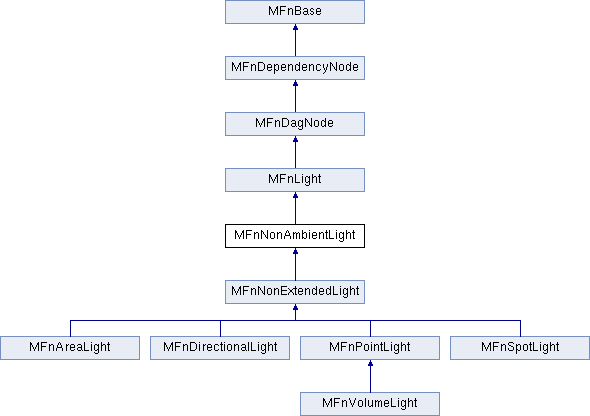

Inheritance diagram for MFnNonAmbientLight:Public Member Functions | |

Manage Non-ambient Light dependency Nodes.
MFnNonAmbientLight facilitates modification of dependency graph nodes representing non-ambient lights. This includes area lights, linear lights, and non-extended lights.

Function set type.
Return the class type : MFn::kNonAmbientLight.
Reimplemented from MFnLight.
Reimplemented in MFnSpotLight, MFnNonExtendedLight, MFnAreaLight, MFnDirectionalLight, MFnPointLight, and MFnVolumeLight.
