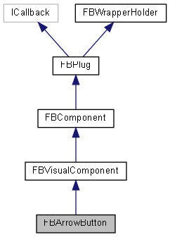

Inheritance diagram for FBArrowButton:

Detailed Description
Creates a button which opens a layout to display content.
When pushed a layout to display content (another control or a layout) is opened. A small arrow to the left of the button title, shows whether the content is shown (points down) or not (points to the title).
Definition at line 1117 of file fbcontrols.h.
◆ FBArrowButton()
Constructor.
Member Function Documentation
◆ SetContent()
void SetContent ( const char *  pTitle,
FBVisualComponent pContent,
int  pContentWidth,
int  pContentHeight
Sets the content to be hidden/shown by button.
The FBArrowButton must already have been added to a layout before calling this method.
Parameters
pTitleTitle of the content managed by the FBArrowButton
pContentContent that the FBArrowButton displays or hides
pContentWidthWidth of the content
pContentHeightHeight of the content
