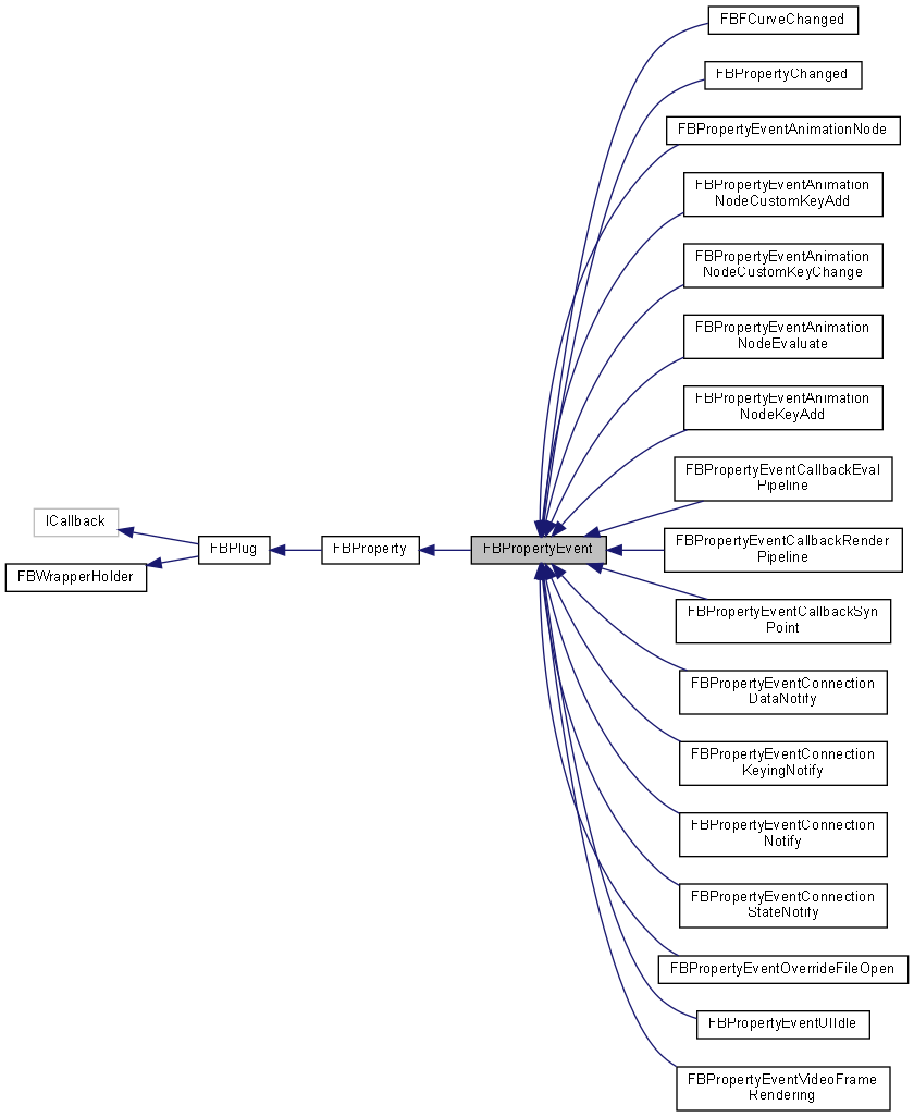

PropertyEvent: Base event class. More...
User could register custom callback function to FBPropertyEvent and perform necessary custom tasks.
Multiple callbacks could be registered to single event, and they will called in the reverse order of registration.
User could add python callbacks via pyfbsdk (if exposed). Those python callbacks which throws exceptions will be unregistered automatically
Definition at line 514 of file fbproperties.h.
