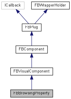

Inheritance diagram for FBBrowsingProperty:
