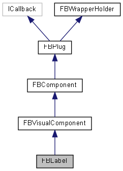

Inheritance diagram for FBLabel:

Detailed Description
Text label.
Definition at line 1176 of file fbcontrols.h.
◆ FBLabel()
FBLabel ( )
Constructor.
Member Function Documentation
◆ SetBackgroundDrawing()
void SetBackgroundDrawing ( bool  pDrawBackGround)
Sets whether a background is drawn for the label.
Parameters
pDrawBackGroundBackground drawing enable or not.
◆ SetTextColor()
void SetTextColor ( const FBColorAndAlpha pColorRGBA)
Sets the label text color.
Parameters
pColorRGBANew text color.
Member Data Documentation
◆ Justify
FBPropertyTextJustify Justify
Read Write Property: Text justification for label.
Definition at line 1194 of file fbcontrols.h.
◆ Style
FBPropertyTextStyle Style
Read Write Property: Text style appearance.
Definition at line 1195 of file fbcontrols.h.
◆ WordWrap
FBPropertyBool WordWrap
Read Write Property: Enable wordwrap on text drawing.
Definition at line 1196 of file fbcontrols.h.
