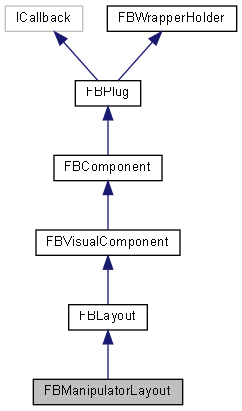

Inheritance diagram for FBManipulatorLayout:

Detailed Description
Manipulator layout class.
Definition at line 106 of file fbmanipulatorlayout.h.
◆ FBManipulatorLayout()
FBManipulatorLayout ( FBManipulator pManipulator = NULL)
Constructor.
Parameters
pManipulatorManipulator to association with Manipulator layout.
Member Data Documentation
◆ Manipulator
FBPropertyManipulator Manipulator
Property: Manipulator.
Definition at line 120 of file fbmanipulatorlayout.h.
◆ MaxSize
FBPropertyInt MaxSize[2]
Maximum Size (Disabled in this version). A value of -1 means no maximum size. (0:Width, 1:Height. Default = -1x-1)
Definition at line 117 of file fbmanipulatorlayout.h.
◆ MinSize
FBPropertyInt MinSize[2]
Minimum Size. A value of -1 means no minimum value. (0:Width, 1:Height. Default = 140x-1).
Definition at line 118 of file fbmanipulatorlayout.h.
◆ StartSize
FBPropertyInt StartSize[2]
Starting Size. This is the initial size when the manipulator is opened. (0:Width, 1:Height. Default = 800x400)
Definition at line 116 of file fbmanipulatorlayout.h.
