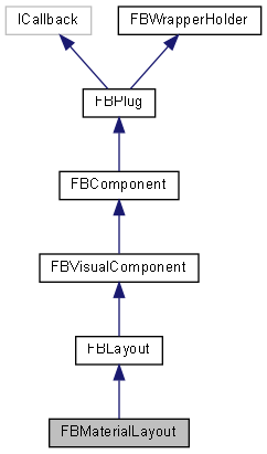

Inheritance diagram for FBMaterialLayout:

Detailed Description
Material layout class.
Definition at line 107 of file fbmateriallayout.h.
◆ FBMaterialLayout()
FBMaterialLayout ( FBMaterial pMaterial = NULL)
Constructor.
Parameters
pMaterialMaterial to association with Material layout.
Member Data Documentation
◆ Material
FBPropertyMaterial Material
Property: Material.
Definition at line 117 of file fbmateriallayout.h.
The documentation for this class was generated from the following file:
