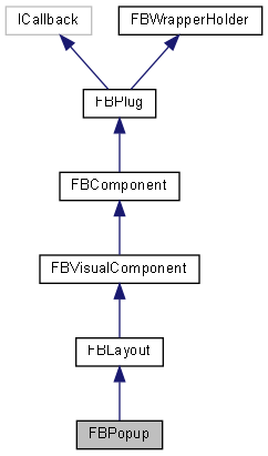

Inheritance diagram for FBPopup:

Detailed Description
Popup window.
This class lets a window (inheriting from FBLayout) be created for another interface.
Definition at line 1988 of file fbcontrols.h.
