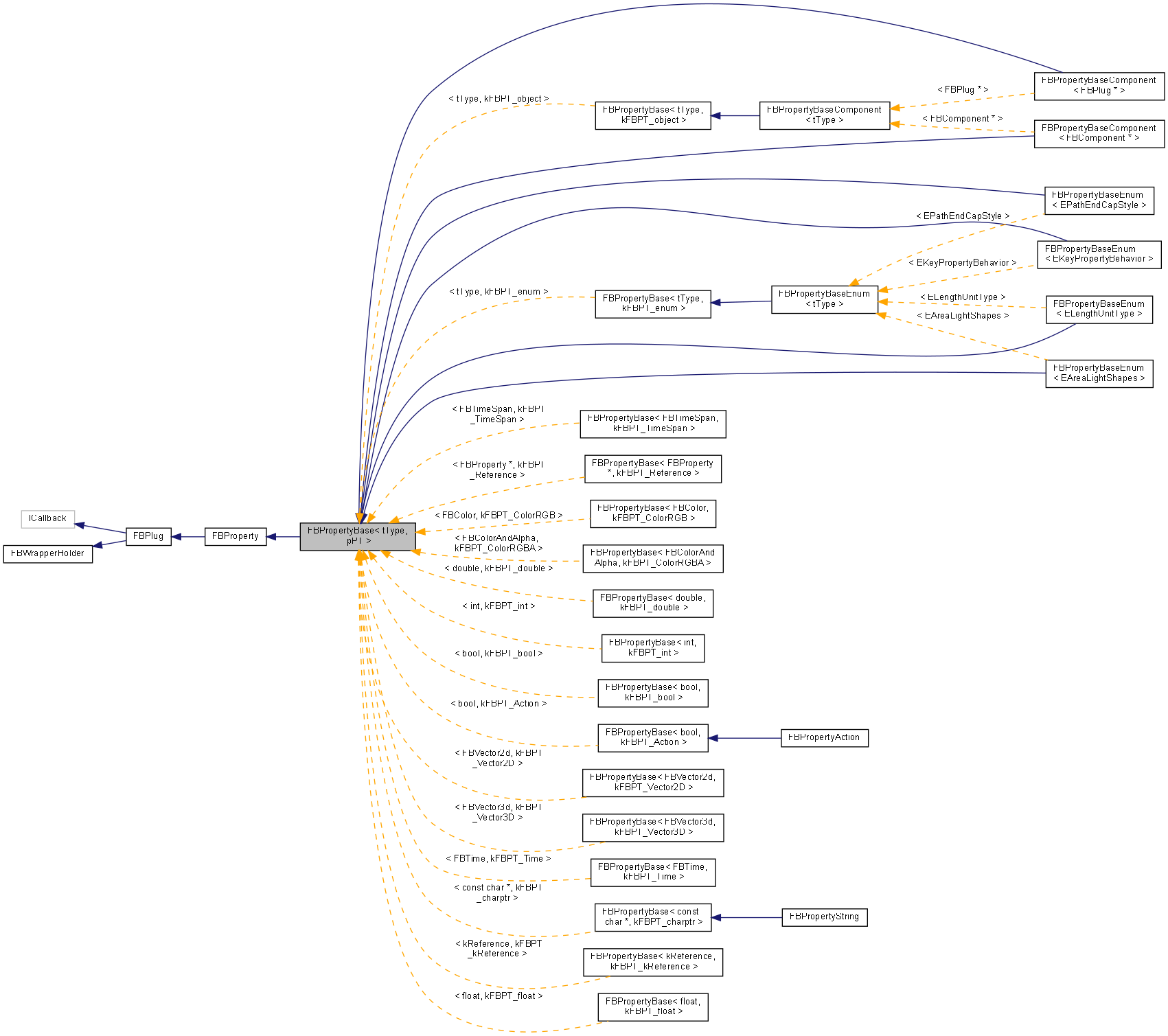

Inheritance diagram for FBPropertyBase< tType, pPT >:
