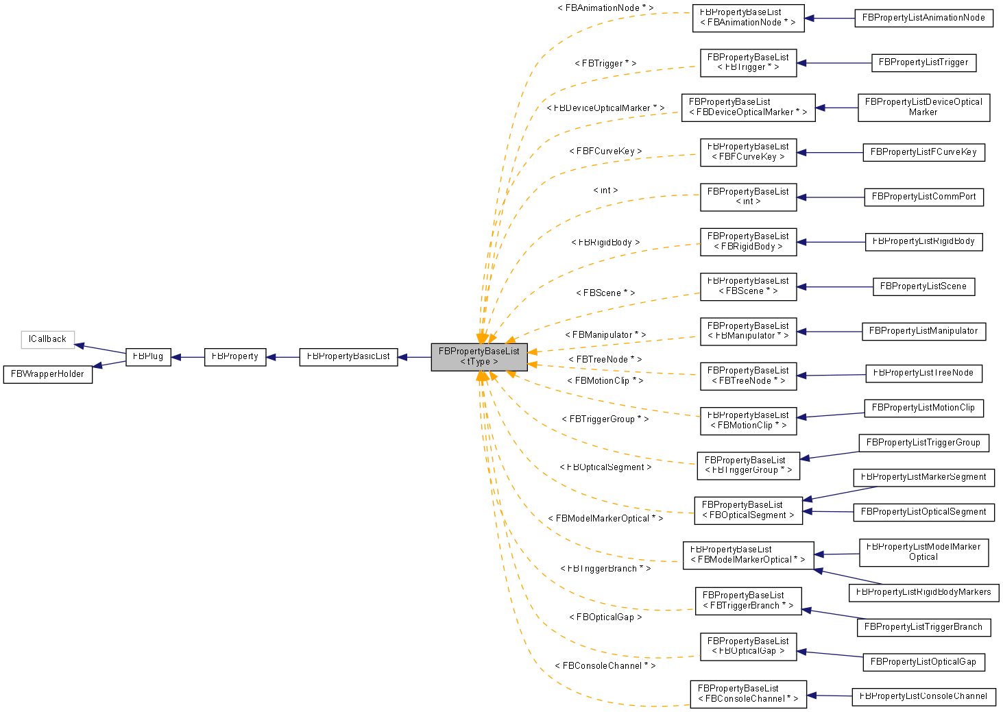

Inheritance diagram for FBPropertyBaseList< tType >:
