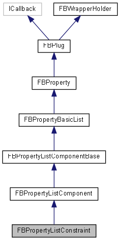

Inheritance diagram for FBPropertyListConstraint:
