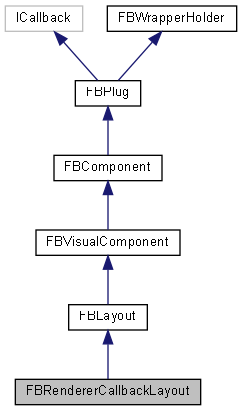

Inheritance diagram for FBRendererCallbackLayout:

Detailed Description
RendererCallback layout class.
Definition at line 108 of file fbrenderercallbacklayout.h.
◆ FBRendererCallbackLayout()
FBRendererCallbackLayout ( FBRendererCallback pRendererCallback = NULL)
Constructor.
Parameters
pRendererCallbackRendererCallback to association with RendererCallback layout.
Member Data Documentation
◆ RendererCallback
FBPropertyRendererCallback RendererCallback
Property : RendererCallback.
Definition at line 118 of file fbrenderercallbacklayout.h.
The documentation for this class was generated from the following file:
