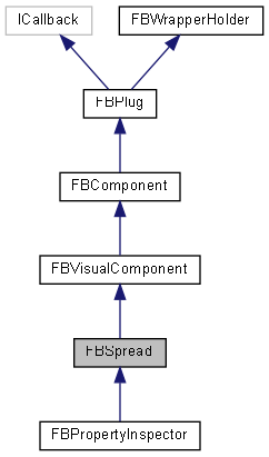

Inheritance diagram for FBSpread:

Detailed Description
Base spreadsheet class.
Definition at line 1520 of file fbcontrols.h.
