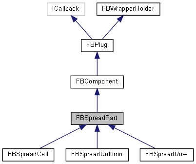

Inheritance diagram for FBSpreadPart:

Detailed Description
Spreadsheet part.
Remarks
Due to protected constructor, this can only be created by a child object.
Definition at line 1437 of file fbcontrols.h.
