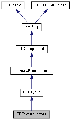

Inheritance diagram for FBTextureLayout:

Detailed Description
Custom Texture layout class.
Definition at line 107 of file fbtexturelayout.h.
