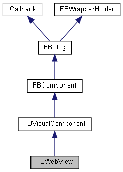

Inheritance diagram for FBWebView:

Detailed Description
Web viewer.
Definition at line 2153 of file fbcontrols.h.
◆ FBWebView()
FBWebView ( )
Constructor.
Member Function Documentation
◆ Load()
void Load ( const char *  pURL)
Load the specified Url.
Parameters
pURLurl to load in the WebView.
