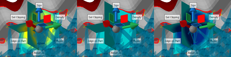

Editing the density map is done by a the control gizmo that can be moved around the build platform.
The three panes show a color-coded cross section of the volumetric map at its current location. Teal color represents zero density change, yellow and red an increase, and blue a decrease in density. Shown here is the editor for spherical changes.
Size |
Offers a slider to modify the size of the volume affected by any change. |
Density |
Provides a slider to modify the local density change information. Releasing the slider applies the change immediately, and any affected supports are recalculated. |
Reset |
Resets the local map volume to no change. |
Reset All |
Resets the entire map to no change. |
Align on Part |
Click this button once, then once somewhere on a part to position the control's center on the part surface at the chosen location. |
Set Clipping |
Positions the clipping planes at the density map controls. Note: This only positions the clipping planes but will not switch any visibility or transparency. Use the clipping planes controls to do this as required.
