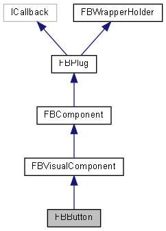

Used to create and manage buttons in a user interface. More...
#include <fbcontrols.h>
This class includes functionality to create buttons in a user interface and add a callback. In MotionBuilder, buttons are created within regions, which are in turn created in layouts with FBLayout. For usage, see the Python sample Button.py. See also: FBButtonStyle, FBTextJustify, FBButtonLook.
Definition at line 1065 of file fbcontrols.h.
| FBButton | ( | ) |
Constructor.
| FBColor GetStateColor | ( | FBButtonState | pState | ) |
Queries the color associated with a button state.
This method is only useful for buttons of style kFB2States.
| pState | The state to be queried. |
| void HookToButton | ( | FBButton * | pButton | ) |
Sets a link to another button.
| pButton | Target button |
| void SetImageFileNames | ( | const char * | pUpImage, |
| const char * | pDownImage = 0, |
| const char * | pThirdImage = 0, |
| bool | pFromResources = false |
Sets the image used to generate a kFBBitmap2States.
| pUpImage | The image used when button is unpushed |
| pDownImage | The image used when button is pushed |
| pThirdImage | |
| pFromResources | Add resource path to image path. |
| void SetStateColor | ( | FBButtonState | pState, |
| const FBColor & | pColor | ||
Returns whether or not the item pIndex is currently selected.
| pState | The state to be set. |
| pColor | The desired color vector. |
| FBPropertyTextJustify Justify |
Read Write Property: Current state of button.
Definition at line 1099 of file fbcontrols.h.
| FBPropertyButtonLook Look |
Definition at line 1100 of file fbcontrols.h.
| FBPropertyEvent OnClick |
Event: Button clicked.
Definition at line 1102 of file fbcontrols.h.
| FBPropertyEvent OnDragAndDrop |
Event: Something was dragged.
Definition at line 1103 of file fbcontrols.h.
| FBPropertyInt State |
Definition at line 1097 of file fbcontrols.h.
| FBPropertyButtonStyle Style |
Read Write Property: Button style.
Definition at line 1098 of file fbcontrols.h.
