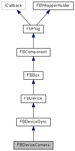

Camera device base class. More...
#include <fbtracker.h>
Based on the FBDeviceSync class, this class generalizes the concept of a virtual set camera driver, permitting synchronization with a genlock source, generic camera connectors, and model templates.
Definition at line 286 of file fbtracker.h.
