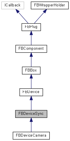

Sync'ed device class. More...
#include <fbtracker.h>
Public Member Functions | |
| FBDeviceSync (const char *pName, HIObject pObject=NULL) | |
| Constructor. More... | |

Public Attributes | |
| FBPropertyInt | PacketBufferSize |
| Property: Packet buffer size(default=100). More... | |
| FBPropertyInt | SyncDelay |
| Property: Synchronization delay (in sync count units). More... | |
| FBPropertyBool | DebugInfo |
| Property: Debugging Info? More... | |
