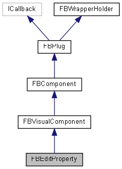

Property editor widget. More...
#include <fbcontrols.h>
Public Member Functions | |
| FBEditProperty () | |
| Constructor. More... | |
