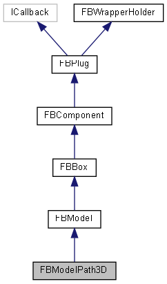

Path 3D model class. More...
#include <fbmodelpath3d.h>
Definition at line 63 of file fbmodelpath3d.h.
