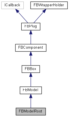

Root object class. More...
#include <fbmodel.h>

| FBModelRoot | ( | const char * | pName, |
| HIObject | pObject = NULL |
Constructor.
| pName | Name of root. |
| pObject | For internal use only(default=NULL). |
| FBPropertyDouble Size |
