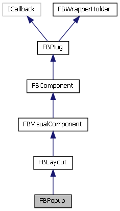

Popup window. More...
#include <fbcontrols.h>
Public Member Functions | |
| FBPopup () | |
| Constructor. More... | |
| virtual bool | Show (FBVisualComponent *pParent=NULL) |
| Show popup. More... | |
| virtual void | Close (bool pOk=false) |
| Close popup. More... | |
Public Member Functions inherited from FBLayout | |
| FBLayout (HIObject pObject=NULL) | |
| virtual bool | AddRegion (const char *pName, const char *pTitle, int pX, FBAttachType pXType, const char *pXRelative, float pMultX, int pY, FBAttachType pYType, const char *pYRelative, float pMultY, int pW, FBAttachType pWType, const char *pWRelative, float pMultW, int pH, FBAttachType pHType, const char *pHRelative, float pMultH) |
| Add a region to the layout. More... | |
| virtual bool | MoveRegion (const char *pName, int pX, int pY) |
| Move a region. More... | |
| virtual bool | SizeRegion (const char *pName, int pW, int pH) |
| Change a region's size. More... | |
| virtual bool | RemoveRegion (const char *pName) |
| Remove a region. More... | |
| virtual bool | RenameRegion (const char *pOldName, const char *pNewName) |
| Rename a region. More... | |
| virtual bool | GetRegion (const char *pName) |
| Verify if a region with pName exists. More... | |
| virtual bool | GetRegionPositions (const char *pName, bool pComputed, int *pX, int *pY, int *pW=NULL, int *pH=NULL) |
| Get region pName information (position and size) More... | |
| virtual bool | SetControl (const char *pName, FBVisualComponent *pComponent) |
| Set control of a region to a visual component. More... | |
| virtual bool | SetControl (const char *pName, FBVisualComponent &pComponent) |
| virtual void | ClearControl (const char *pName) |
| Remove a control from a region in a visual component. More... | |
| virtual FBVisualComponent * | GetControl (const char *pName) |
| Get control of a region in a visual component. More... | |
| virtual HIKtObject | GetHIKtObject (const char *pName) |
| Set or Get internal toolkit: object. More... | |
| virtual bool | SetHIKtView (const char *pName, HIKtView pView) |
| Set internal toolkit view. More... | |
| virtual HIKtView | GetHIKtView (const char *pName) |
| Get internal toolkit view. More... | |
| virtual bool | SetView (const char *pName, FBVisualComponent *pComponent) |
| Set view. More... | |
| virtual bool | SetView (const char *pName, FBVisualComponent &pComponent) |
| virtual bool | SetBorder (const char *pName, FBBorderStyle pType, bool pShowTitle, bool pInSet, int pWidth, int pSpacing, float pMaxAngle, int pCornerRadius) |
| Set border properties for a region. More... | |
| virtual bool | SetSplitStyle (const char *pName, FBSplitStyle pRegionType) |
| Set a region's splitstyle. More... | |
| virtual FBSplitStyle | GetSplitStyle (const char *pName) |
| Get a region's splitstyle. More... | |
| virtual bool | SetRegionTitle (const char *pName, const char *pTitle) |
| Set a region's title. More... | |
| void | SetAutoRestructure (bool pAutoRestructure) |
| Suspend all automatic layout recomputation. More... | |
| void | Restructure (bool pNoMove) |
| Force a recomputation of all region placements in the layout. More... | |
| IObject_Declare (override) | |
Public Member Functions inherited from FBVisualComponent | |
| FBVisualComponent (HIObject pObject) | |
| ICallback_Declare (override) | |
| virtual HIKtView | GetKtView () |
| Get internal toolkit object. More... | |
| QWidget * | GetQWidgetAddress () |
| Get internal QWidget. More... | |
| virtual bool | AddChild (FBVisualComponent *pChild, int pId=0) |
| Add a child component. More... | |
| virtual FBVisualComponent * | GetChild (int pId=0) |
| Get a child component. More... | |
| virtual void | Refresh (bool pNow=false) |
| Refresh component. More... | |
| virtual void | ViewExpose () |
| Exposed view callback function. More... | |
| virtual void | ViewInput (int pMouseX, int pMouseY, FBInputType pAction, int pButtonKey, int pModifier) |
| Input callback function. More... | |
| virtual bool | IsView () |
| Is component a view? More... | |
Public Member Functions inherited from FBComponent | |
| FBComponent (HIObject pObject) | |
| virtual | ~FBComponent () |
| Destructor. More... | |
| virtual bool | FBCreate () |
| Open Reality Creation function. More... | |
| virtual void | FBDestroy () |
| Open Reality destruction function. More... | |
| virtual void | FBDelete () override |
| Open Reality deletion function. More... | |
| virtual bool | SetHIObject (HIObject pObject, bool pSDKComponent) override |
| Assign component to an internal pointer. More... | |
| virtual int | PropertyAdd (FBProperty *pProperty) |
| Add a property to the component's property manager. More... | |
| bool | PropertyAddReferenceProperty (FBProperty *pReferenceProperty) |
| Add a reference property to the component's property manager. More... | |
| void | PropertyRemove (FBProperty *pProperty) |
| Remove a Property from the component's Property manager. More... | |
| void | PropertyGetModifiedList (FBArrayTemplate< FBProperty * > &pPropList, FBPlugModificationFlag pModificationFlags) |
| Get list of properties which have been modified since last loading. More... | |
| FBProperty * | PropertyCreate (const char *pName, FBPropertyType pType, const char *pDataType, bool pAnimatable, bool pIsUser=false, FBProperty *pReferenceSource=NULL) |
| Create user or dynamic property. More... | |
| FBObjectFlag | GetObjectFlags () |
| Get all Object Flags (concatenated). More... | |
| void | SetObjectFlags (FBObjectFlag pFlags) |
| SetObjectFlags. More... | |
| bool | HasObjectFlags (FBObjectFlag pFlags) |
| Check whether a specific object flag is enabled. More... | |
| void | EnableObjectFlags (FBObjectFlag pFlags) |
| Enable a specific Object Flags. More... | |
| void | DisableObjectFlags (FBObjectFlag pFlags) |
| Disable a specific Object Flags. More... | |
| void | SetObjectStatus (FBObjectStatus pStatus, bool pValue) |
| Enable/Disable a specific Object Status. More... | |
| bool | GetObjectStatus (FBObjectStatus pStatus) |
| Check to see if an object status is enabled. More... | |
| bool | ProcessNamespaceHierarchy (FBNamespaceAction pNamespaceAction, const char *pNamespaceName, const char *pReplaceTo=NULL, bool pAddRight=true) |
| ProcessNamespaceHierarchy. More... | |
| bool | ProcessObjectNamespace (FBNamespaceAction pNamespaceAction, const char *pNamespaceName, const char *pReplaceTo=NULL, bool pAddRight=true) |
| ProcessObjectNamespace. More... | |
| virtual const char * | ClassName () override |
| Get the class name. More... | |
| virtual bool | UseCustomPropertyViewSet () const |
| Use the custom property viewSet or not. More... | |
| const char * | GetFullName (void) |
| Get the full name. More... | |
| void | SetOwnerNamespace (FBNamespace *pOwnerNSObj) |
| Set the owner Namespace object. More... | |
| FBNamespace * | GetOwnerNamespace (void) |
| Get the owner Namespace object. More... | |
| FBFileReference * | GetOwnerFileReference (void) |
| Get the owner FileReference object. More... | |
| void | HardSelect () |
| HardSelect. More... | |
| virtual bool | Is (int pTypeId) override |
| Returns true if object is of type TypeId. More... | |
| virtual int | GetTypeId () override |
| GetTypeId( int pTypeId ) More... | |
Public Member Functions inherited from FBWrapperHolder | |
| FBScriptWrapper * | GetWrapper () |
| Return the wrapper interface of this FBObject. More... | |
| void | AddWrapper (FBScriptWrapper *) |
| void | RemoveWrapper (FBScriptWrapper *) |
Public Attributes | |
| FBPropertyString | Caption |
| Read Write Property: Caption to display in popup. More... | |
| FBPropertyBool | Modal |
| Read Write Property: Modal? More... | |
Public Attributes inherited from FBLayout | |
| FBPropertyEvent | OnInput |
| Event: Input. More... | |
| FBPropertyEvent | OnPaint |
| Event: Paint layout. More... | |
| FBPropertyEvent | OnIdle |
| Event: Idle. More... | |
| FBPropertyEvent | OnShow |
| Event: Show layout. More... | |
| FBPropertyEvent | OnResize |
| Event: Resize layout. More... | |
Public Attributes inherited from FBVisualComponent | |
| struct FBVisualComponent::__Region | Region |
| struct K_DLLEXPORT FBVisualComponent::__Border | Border |
| Property: Widget caption. More... | |
| FBPropertyBool | Visible |
| Read Write Property: Is visual component visible? More... | |
| FBPropertyBool | ReadOnly |
| Read Write Property: Is visual component read only? More... | |
| FBPropertyBool | Enabled |
| Read Write Property: Is visual enabled? More... | |
| FBPropertyString | Hint |
| Read Write Property: Hint to show. More... | |
| FBPropertyInt | Left |
| Read Write Property: Left coordinate. More... | |
| FBPropertyInt | Top |
| Read Write Property: Top coordinate. More... | |
| FBPropertyInt | Width |
| Read Write Property: Width. More... | |
| FBPropertyInt | Height |
| Read Write Property: Height. More... | |
| FBPropertyEvent | OnEnter |
| Event: On mouse enter. More... | |
| FBPropertyEvent | OnExit |
| Event: On mouse exit. More... | |
Public Attributes inherited from FBComponent | |
| FBPropertyManager | PropertyList |
| Read Only Property: Manages all of the properties for the component. More... | |
| FBPropertyListComponent | Components |
| List: List of components. More... | |
| FBPropertyListComponent | Parents |
| List: Parents. More... | |
| FBPropertyBool | Selected |
| Read Write Property: Selected property. More... | |
| FBPropertyString | Name |
| Read Write Property: Unique name of object. More... | |
| FBPropertyString | LongName |
| Read Write Property: Name and namespace for object. More... | |
| FBPropertyFolder | Folder |
| Read Write Property: The folder that contain this component. More... | |
Additional Inherited Members | |
Public Types inherited from FBLayout | |
| enum | FBSplitStyle { kFBNoSplit = 0 , kFBHSplit = 1 , kFBVSplit = 2 , kFBHVSplit = 3 } |
| Type of split style (sub-division) for layout. More... | |
Static Public Member Functions inherited from FBComponent | |
| static int | GetInternalClassId () |
| static void | FBComponentSetName (FBComponent *pObject, const char *pName) |
| static const char * | FBComponentGetName (FBComponent *pObject) |
| static void | FBComponentSetLongName (FBComponent *pObject, const char *pName) |
| static const char * | FBComponentGetLongName (FBComponent *pObject) |
Static Public Attributes inherited from FBComponent | |
| static int | TypeInfo |
| Contains the Type information of the object. More... | |
Protected Member Functions inherited from FBVisualComponent | |
| virtual HIKtObject | GetHIKtObject () |
Protected Member Functions inherited from FBPlug | |
| bool | IsSDKComponent () |
| Return whether or not item is an SDK component. More... | |

Popup window.
This class lets a window (inheriting from FBLayout) be created for another interface.
Definition at line 1988 of file fbcontrols.h.
| FBPopup | ( | ) |
Constructor.
virtual |
Close popup.
| pOk | Equivalent of OK button clicked if true (default = false). |
virtual |
Show popup.
| pParent | Parent object for popup |
| FBPropertyString Caption |
Definition at line 2006 of file fbcontrols.h.
| FBPropertyBool Modal |
Definition at line 2007 of file fbcontrols.h.
