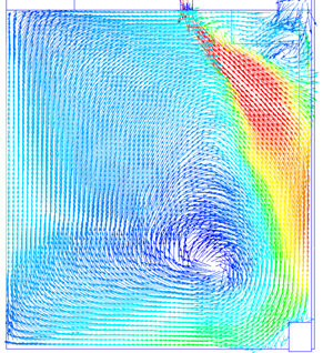

Mechanical Ventilation
Mechanical Ventilation analyses simulate the air flow in spaces that are controlled with air management systems. Such systems typically include a network of diffusers, fans, and returns designed to ensure proper air flow and temperature control within the occupied area.

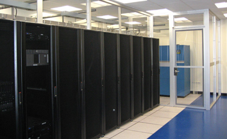

Data Center Optimization

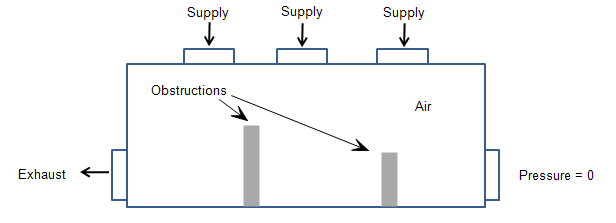

Most mechanical ventilation applications consist of the following elements:
- Air regions
- Internal obstructions
- Supply (vents, diffusers, fans, etc.)
- Exhaust (registers, vents, fans, etc.)
Primary modeling considerations for Mechanical Ventilation models include:
- Simplify the geometry to remove extraneous features. Simplify or rebuild parts to remove detail that is not relevant to the simulation.
- The model must contain an air volume within the device. This is a consideration because the physical model probably does not contain one. Autodesk® CFD automatically creates an internal volume if the geometric model is "airtight." If not, modify the CAD model to close any gaps or use the Void Fill tool to create the volume on the Autodesk® CFD model.
- To ensure enough space between the boundary conditions and the internal flow, a good practice is to extend the openings in the CAD model.
- This is useful for flow-only analyses, but is essential when temperature boundary conditions are applied to openings. This practice ensures adequate distance between the opening and the neighboring walls whose temperatures are not known.
- Extend the opening at least the hydraulic diameter of the surface.
These items and several more are presented in detail in the AEC Geometry Modeling topic...

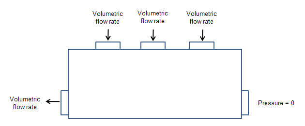

Air is mechanically moved in and out of the interior space at known conditions. Use boundary conditions to specify these conditions and their locations.
- Inlets: assign Volume flow rate on each inlet (diffuser or supply air location).
- Outlets: assign Static Gage Pressure = 0 on all outlets (returns, exhaust, or openings).
If all inlet and outlet flow rates are known, assign a volume flow rate condition to all openings, except one. Assign a Static Gage Pressure = 0 to this remaining outlet.
Some additional considerations for flow boundary conditions:
- Specify flow boundary conditions on the outermost surfaces of the model.
- Assign either a flow rate or a pressure to openings, but not both.
- At least one pressure boundary condition must be specified in the model.
When assigning flow conditions, it is always a good idea to verify the flow direction with the arrow displayed on the surface. If the arrow indicates the flow is in the wrong direction, click the Reverse normal button on the Boundary Condition quick edit dialog.

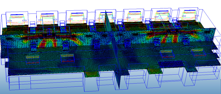

A basic guideline for a high-quality analysis model is that the mesh distribution be sufficient to resolve the flow and temperature gradients efficiently. In regions where the flow circulates or experiences large gradients (such as in wakes, vortices, and separation regions), a finer mesh is required.
For most models, use Automatic Sizing to define the mesh distribution. It may be necessary to locally refine the mesh on geometric features that are highly detailed. For more information about Mesh Autosizing and model preparation...
In some cases, it may be necessary to adjust the Minimum Refinement Length to reduce their effect on the overall mesh count.
To locally refine the mesh in high-gradient flow regions:
- Adjust the mesh distribution on geometric volumes and surfaces.
- If there are no appropriate geometric features in a particular region, create a mesh refinement region:
- Add one or more volumes in the CAD model.
- Create a Refinement Region from the Meshing task.
Click here for more about mesh strategies for AEC applications...
