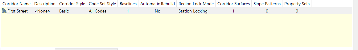

The Object List pane
A list of objects in the selected object category along with a series of key parameters for each listed object. Parameters which are highlighted against a white background are directly editable from Project Explorer by double-clicking the displayed value. Objects which are displayed in red indicate the presence of a design violation of some sort. Hover your mouse over any such object to display a tooltip which provides more information about the nature of the violation.

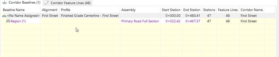

The sub-object list pane contains a list which is populated when an object selection is made from the user interface. The nature of each listed sub-object will depend on the type of object selected, but can include things like points, parcel segments, corridor baselines and regions, surface triangles, surface cells, and alignment or profile entities. Again, sub-object parameters which are highlighted against a white background are directly editable from Project Explorer by double-clicking the displayed value. Sub-object elements which are displayed in red indicate the presence of a design violation of some sort. Hover your mouse over any such sub-object to display a tooltip which provides more information about the nature of the violation.
