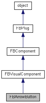

Creates a button which opens a layout to display content.
When pushed a layout to display content (another control or a layout) is opened. A small arrow to the left of the button title, shows whether the content is shown (points down) or not (points to the title).
