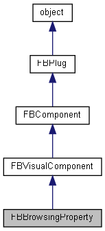

Property browsing. More...
#include <pyfbsdk_generated.h>
Public Member Functions | |
| FBBrowsingProperty () | |
